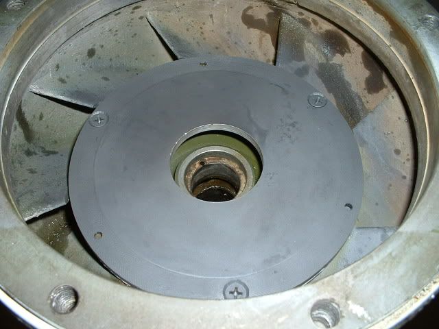

Jet Pumps / Re: bowl stuffer installation..how to..pics/install
« on: February 29, 2008, 06:28:38 PM »
Overkill or not, that is just purdy!
Thanks, I gotta modify it once more to fit in that bowl ::)  Its just sittin in there, and slightly change the cone shape to fit the hi-helix.
« on: February 29, 2008, 02:48:56 PM »
after seeing that one (agressor), is the one I have going to actually worth the time and effort for the gain it will produce?, and I think the smart thing also would be to tap and fill my existing holes, and re drill them the way you have it set up, it would probably be easier and safer and stronger (versus, fishing out the shavings, drilling and tapping, into oil resevoir)
Truthfully, a plate stuffer would work very well for you,  I'm not quite sure if the one I built was worth the time or effort but it was fun.  Heres what an aggressor one looks like from aggressor.
But there is a machined area in an aggressor bowl for it to sit in, it wouldn't bolt into a berkeley bowl, without some work
« on: February 29, 2008, 02:05:36 PM »
Cool !! Thanx.
 Would it flow more if it where cone shaped or is something else in front of it?
I spent way too much time on this one, but somewhere buried amonst more aluminum it started out as an Aggressor cone stuffer.  This one fits .025" everywhere :screwy: I think i had too much time on my hands.
Here is the one I have, it looks like the mounting holes are different and champfered on the other side, hmmm, this one is 7-1/4 across 1/2 thick in the center and the taper is approx 5/16
with a 32nd on the front side (as shown in your pic.) My mounting holes are  on a 2 in radius or 4 inch circumfrence, where yours is probably closer to 6-3/4 center
I've seen ppl do that before but be carfull and seal the bolts because they go right into the oil cavity, also make sure and get drill shavings out.
« on: February 29, 2008, 01:27:23 PM »
Found a pic of a simple stuffer, a ledge has been machined on this one to create an L shape mating surface(kinda like a shoulder on a wear ring), How ever I would typically machine the mating surface on the impeller also incase its a hair off center.
« on: February 29, 2008, 10:41:27 AM »
Well I am going to tear into my pump for the first time to install a stuffer. The pump had a new impeller and wear ring installed last summer so hopefully it'll come apart fairly easy. I am thinking/hoping all I will need to do is basically drill/tap install the stuffer plate, re-check tollerances as it goes back together. Is there anything that I should be aware of before I get this thing tore down (special machining ect.) pictures of the mounting would be sweet.
Josh, this post has your name all over it, can you hear it calling your name lol  ;D
 ;D If you are going to install a stuffer plate it should be pretty straight forward.  Take the bowl off, get some modeling clay (playdo) make acouple of balls the size of marbles put at least two on oposite sides of the impeller, put the bowl back on and torque it down(don't turn the shaft).  Remove and measure the squished clay with a pair of calipers, they should measure about the same, if not it wouldn't be bad idea to put a few more on and check it again.  I usually will put the same clearance on the back side of the impeller as I use on the front so take your measurment and subtract .025" -.035" and you know how thick to make your plate.  Also its not a bad idea to drill an 1/8" hole in the bottom of the stuff to drain any water that will get trapped in there.
You can also get real fancy on your stuffer and machine it to fill in the void on the impeller, but thats a whole nother story.
