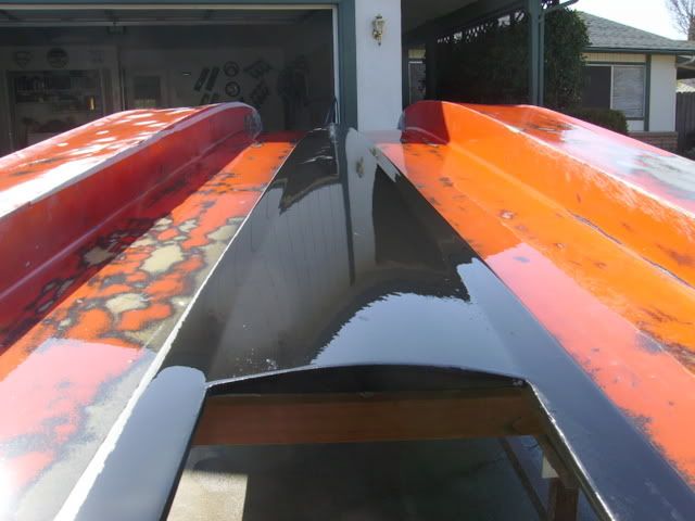

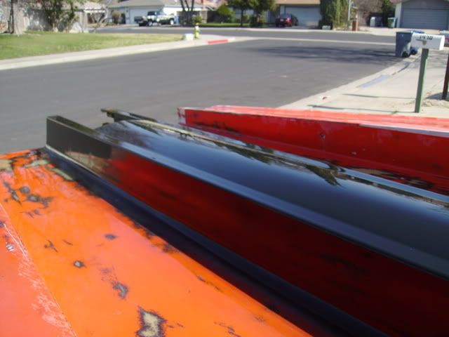

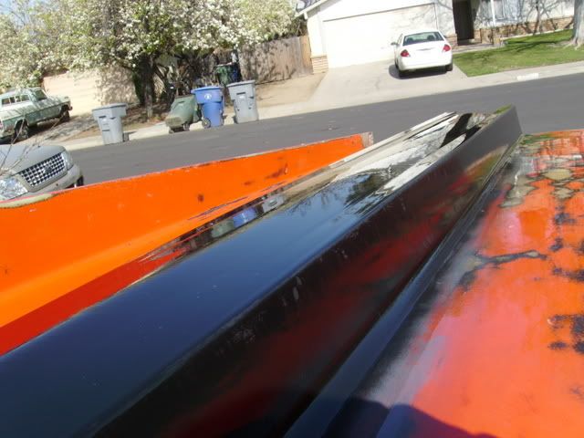

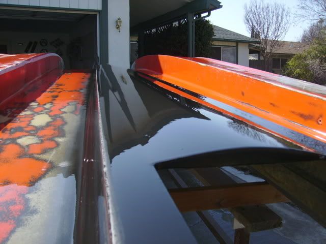

 I did some grinding and rearranging of things today.  The angles where a bit off last night, I actually had to drop the front of the sponson back down 1/2".   Its all held together with wood blocks and metal straps for now.  I'm going to let it sit for a few days and just look and measure for a bit before I start glassing, I dont want to have to cu it back apart.  ::)
 Heres some side to side shots to show the final differences.

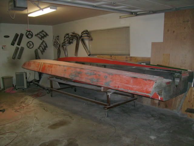

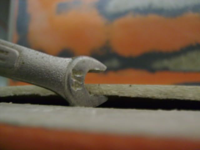

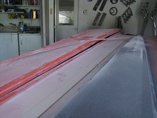

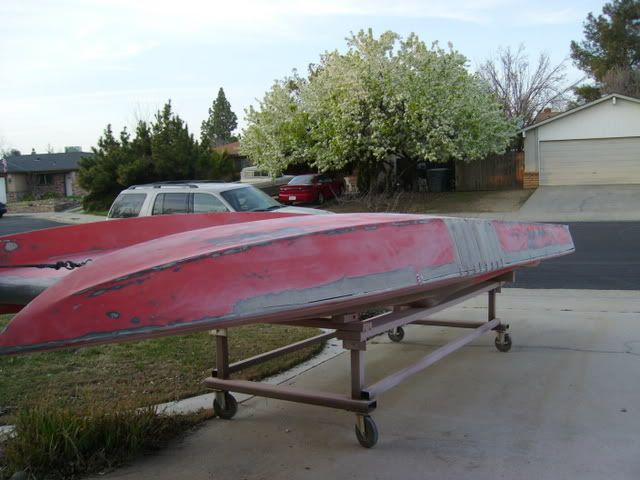

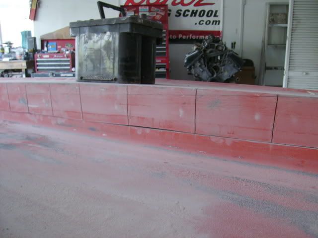

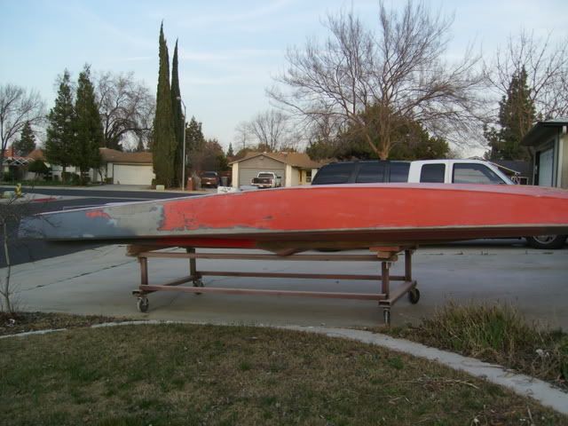

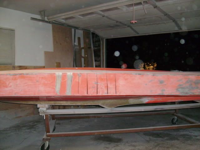

 I attacked one of the sponsons today.  The plan was to drop the rear of the sponson (about 3/4"), and raise the bottom of the sponson at the dash area (about 2"), to create a more modern angle difference between the sponsons and the keel.  As well as to get rid of the huge hump under there at the dash area.
 I made my first main cuts and the damn hull sprung open and twisted all around like a wet noodle.  :banghead: :banghead:   I just sat there looking at it and almost cried.  It almost found its way into a dumpster today.   It took me about 6hrs of twisting, bending, supporting, cutting and screwing in supports to get it back into the shape I wanted.  Still more work to do, maybe another full day before its ready to tab it back together.  But its getting there.
 The first cuts
 The end of the day, its getting there.

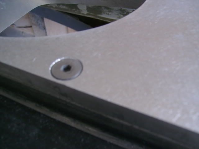

 I had to make a shoe for this stupid intake.  Its a different size than a standard shoe (longer), so I had to make it myself.  I figured I would just start out with a flat shoe and see where it puts me.   Gotta start somewhere.
 I cleaned up the shoe pad, it was a bit corroded and not exactly flat anymore.
 Then I looked around in the spare parts pile and found a piece of 1/2" Aluminum.  It was a piece of the old set back OB mount from the Daytona, so yea, I finally found a use for an OB part.  >:D
 Marked out what I needed and broke out the precision cutting tools.  ::)
 Got it cut and cleaned up a bit.  Then kinda guesstimated where to cut for the leading edge.  Had to make a guess as to where the angle from the inside of the intake would need to end up.  I'm sure theres some kind of math to figure it out, but who has time for that.
 Got the mounting holes drilled (mostly in the right spots  >:() and counter sunk the two front ones.  A couple of the rear holes where slightly off, but nothing drastic.
 Then grabbed the grinder and sander and ground out/blended the inside angle to match the intake. My guesstimate was fairly close, had to grind it back a bit, but thats better than cutting it to short.  ;)
 All done, almost.  Still need to cut the pad for the ride plate, and do a bit of blending at the rear of the intake fins.
