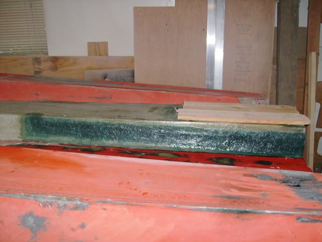

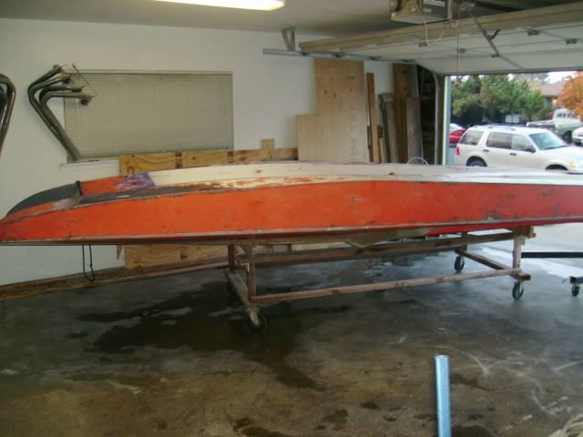

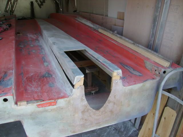

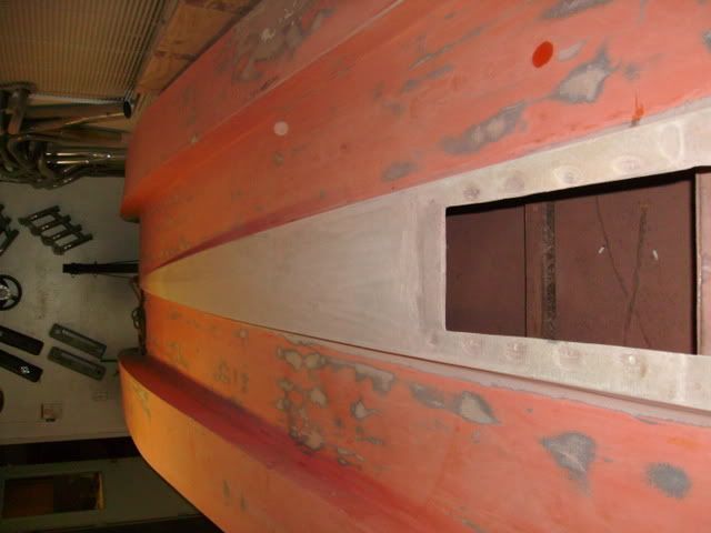

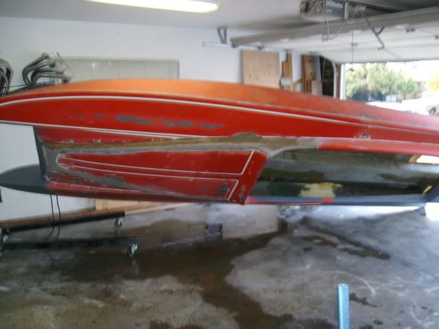

 I decided to start with the keel mods first.
 I stripped it down to glass to get it ready for the work.
 Then it was cuttin time.  Took me a long time actually get up the nerve to do this.  But I figure this stupid old pile of junk was hanging on to edge of a dumpster with one finger when I found it, so I might as well get creative with it.
 I cut along the sides of the center pod and wedged the back down to create a straight keel line.  I spent a few days looking at it, and measuring everything 10 times until I was happy with it.  I also filled the old intake mounting holes from the bottom, got rid of the recess for the factory ride plate and did a little glass work on the area that I filled in for the pump set back.
 Then I put a couple layers of glass on it to hold it together.  Now I can pull the wood I used to hold it in place out of there and start glassin and grindin till its built back up to the right thickness and straight again.
 Thats where I'm at for now, its out in the garage with a heater under it to help the glass set up nice.   Once I get it built back up to be strong again  I can put a rounded shape under there for a round keel intake.   Then its on to the sponsons issues.   ???

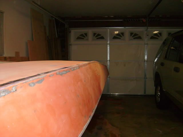

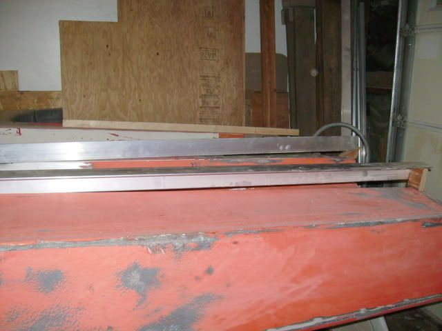

 Still had some of the old paint under there.

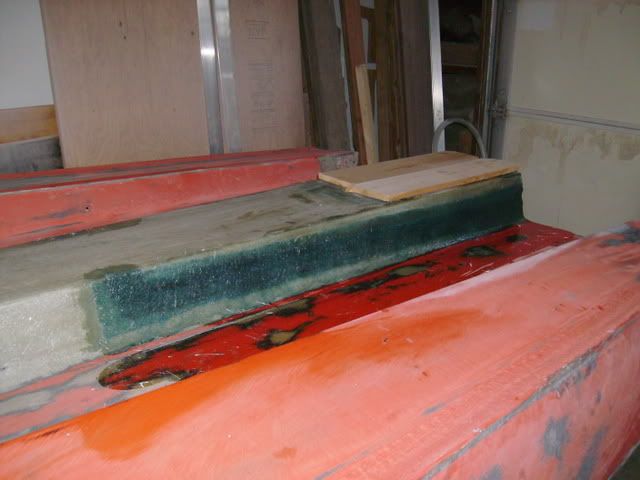

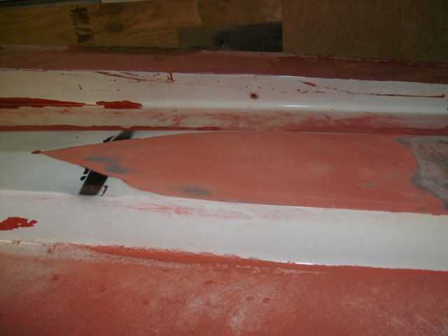

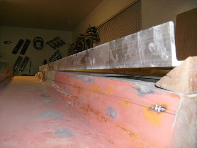

 Started sanding it all off looking at things better and made few interesting discoveries.  It was hard to tell exactly what was going on with the bottom of this thing while it was on the trailer (or on the dolly). But it was easy to see now.   The keel is actually V shaped and it has a Delta pad.  :o
Heres a shot showing the angle change from the actual keel line to the Delta pad.  >:(
 And one showing the huge hump/angle change on the bottoms of the sponsons.
 I dont like any of this !!  So its going to ALL be changed.  ;)
 I spent a lot of time on the phone with some of the gurus, talking about angles and tunnel depths and how the newer hulls are compared to this thing.  It took a lot of planning, measuring, checking angles, over and over and over, but I finally came up with a decent plan to update the bottom.
 Its going to loose the Delta pad and get the bottoms of the sponsons re angled to work with the new keel angle.  This should help the hull run at a better angle through the water.  It will open up the tunnels at the transom a bunch so it wont trap as much air under the bow (let the air flow under the hull better).

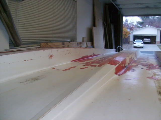

Ok,  lots of updates to do here.

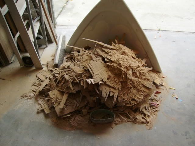

 I got all the wood out from under the underside of the deck, what a pain in the azz that was.
 Heres the pile of "extra" wood that came out.
 Once all the mess was out from inside I decided to flip the hull to take care of its major glass work before going any farther.   Theres just something not quite right about seeing your boat hanging upside down in the air.  :o
 Back on the dolly and ready for some BIG changes.  >:D

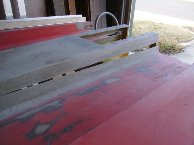

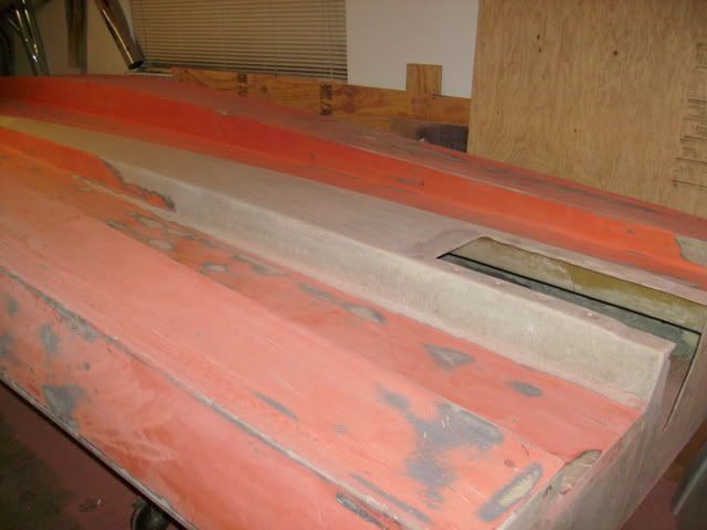

 I went to fill the old holes in the stringers and ran straight into a nightmare.  Even though they looked good, and sounded good when you tapped on them.  The glass was not bonded to the wood anymore.   I got mad a did a quick cut along the bottom edges and all he glass lifted right off like a taco shell.  :mad:   One side came off complete in a 12' length.
  Then I smacked on the stringers with a hammer, and they fell over.  Heres all the glass of the stringers, and the stringers.   :mad:
 So I started stripping the tops of the tunnels down to wood so I could set new stringers in there.

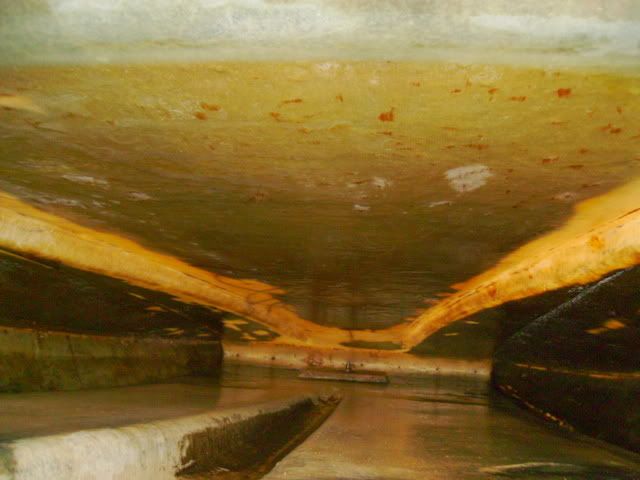

 I got all the way done with one side and about 3/4 done with the other when I found another issue.  Part of the plywood was separating.   There was a split under where the stringer was and the glass was ripping the top layer of wood off the ply.  :banghead: :banghead:
 So as of today,  ALL the plywood has been removed from the hull.  It is a bare fiberglass shell now except for 2 gunnel supports, and the section on the under side of the deck, but that is coming out too.
 You can see the pile of old plywood on the ground next to the boat here.
 The good news is, I dont think theres anywhere on this thing where any more issues can be hiding.   :sly:  And I will get to learn a lot of new skills, like laminating a core back into a floor, and setting stringers, and glassing over new stringers, and flow coating, etc, etc, etc.
