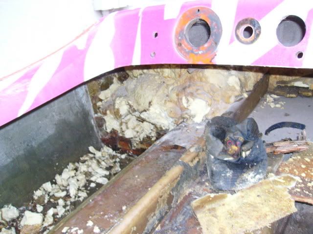

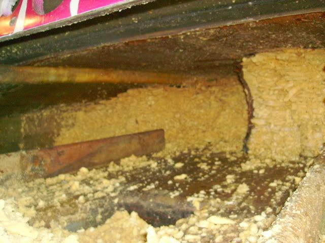

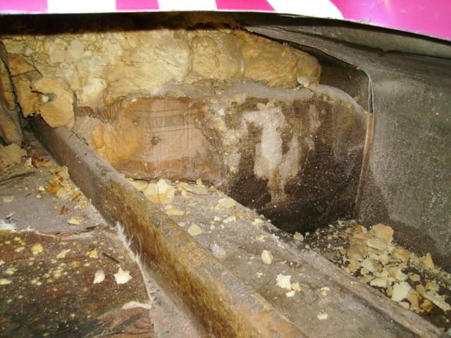

 Did I ever mention theres LOTS of foam under this stupid bow.  :banghead:  I've taken 6 of the big hefty lawn trash bags of that stuff out of there so far, I'm about half way through it. Me and my bright ideas, but it needed to be done.  So far Ive found 1 hat, some cardboard, a couple plastic bags, and a few unidentifiable items in the foam.  Maybe they where saving on there trash bill when they built this one, must have been a Friday boat.  ::) ;D
 One strange thing I found was theres 2 different types of foam under there.  Its not a matter of wet and dry, both types are wet.  Most of the foam is a tannish color and the porta water jet cuts right through it like nothing. But, then there's an area in the pass side sponson where the foam is as white as snow and as hard as a rock. The porta water jet will not cut through it and even a shovel has a tough time with it.  It even feels different, kinda hard and grainy, like white lava rock.  :sly:  I'll get it out even if I have to resort to the sawzall.  >:D

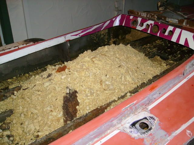

 Damn, theres LOTS of foam under this bow.
 I fired up the pressure washer (from now on to be known as the "porta water jet").  This is the best way to remove foam !!!!!  It slices it up into little chunks like a wood chipper, no dust, no little pieces of foam flying around and sticking to everything.  Thanks again River Roy, Great idea.  :thumbup: :thumbup:
 I didnt have much time to work on it. Had to fix the fuel line on the "porta water jet", and fix the hose that the dog ate (again  >:().  But, heres the pile from tonight.
 Best guess is thats about 1/4 of whats under there.  My trash guy is going to be collecting foam for a couple months.  ::)

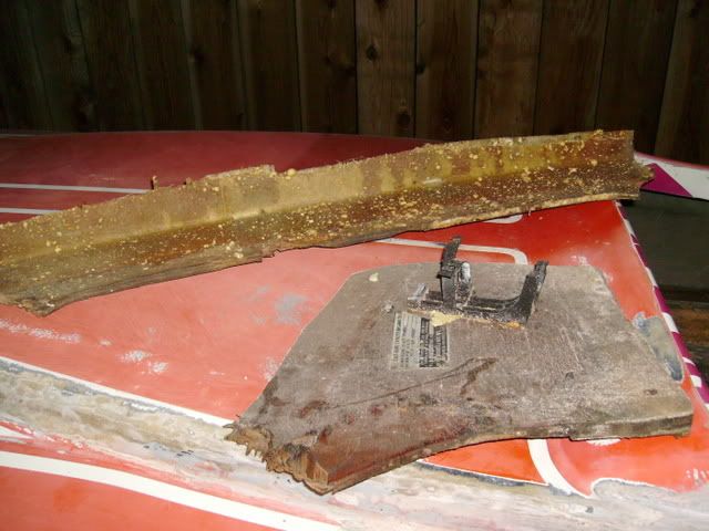

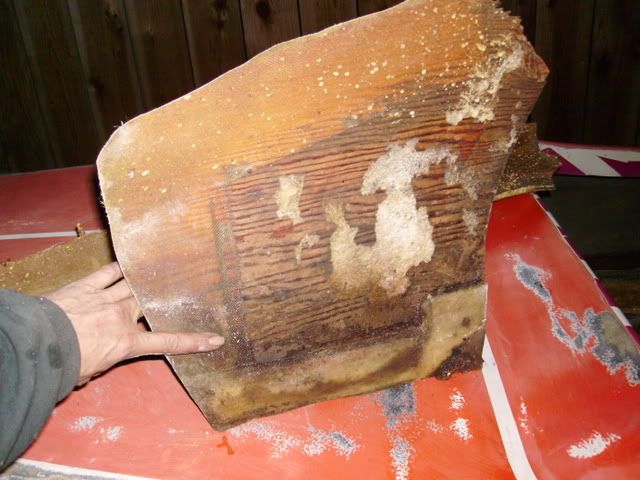

  I cut the rest of the bulkhead out tonight.  I brought my air saw home from work and it did the job really well.
 I found what I though I was going to find on this side, lots of water and nasty water soaked foam.  Here you can see all the black foam.  As soon as the saw got down to the top of the tunnel, water started coming out of the cut.
 You can see on the back of the wood how high the water level was.  Its no wonder the bow of this thing was sooooo heavy.
 Found a broken fuel line on the pressure washer, as soon as I get a chance to fix it I'll see how it does at removing foam.  >:D
