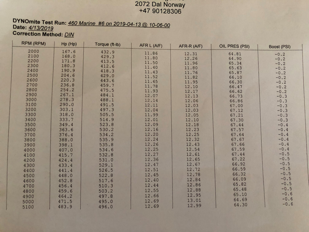

What was the exhaust system used on the dyno? Tubular headers?
And now in the boat the engine has cast manifolds? Well, there's your answer (ie, the reason for your power loss). :)

I was hoping the cast manifold didn't cut the power that much.. right now my boat only have stock performance.
Turning almost exactly the same rpm as the stock 320 HP motor at full throttle.
Guess i need to get some headers on it instead of the cast manifold.. but jacketed headers are not cheap! :-\

You think so Paul, are my cast manifolds destroying my power that much?
I know they are worse than the tubular headers we used in the dyno, but i hoped they were ok up to 500 hp.. ;D
I see others with the same manifolds are running over 5000 rpm...   but i guess that is not an answer saying that it will work on my motor combination ?

Hello.. i got an issue with my boat.
I have a Glastron CVX20 with a Berkeley JE12 pump with A aluminium impeller. Place diverter and the "sports" loader i think.
Pump is recently rebuilt and the impeller looked like new.
Stock this boat comes with Ford 460 rated at 320 Hp, turning the A impeller at 4600 rpm.
Now i have a new built motor, a Ford 466, it did 485 at 5150 rpm in the dyno.
I have been kind to it in the beginning almost just have run it on the primary jets...
So after some days i thought i should open it up and see how it would run at full speed.
At first i notice that the motor stalls for a split second when i open the secondaries, then run as it should..
But it's only turning the A impeller at 4500 rpm.... so i got the same speed as with a stock motor..
What do the jet people think, shouldn't it be going faster?
