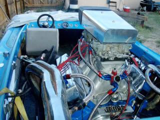

Oh yeah... 4900 rpms. Roughly... 75mph - If I am lucky
Dual 650's, stainless A impeller, all the goodies on the pump. Maybe 500 horsepower? Gained 400 rpm's changing jets on Holley 650's. Gonna try 76's all the way around on new quick fuel 650's. I am starting to think that all this polished aluminum, along with the braided lines, is slowing me down... I think that if i polish the muffler bearings it might go faster. Any thoughts???? :screwy:

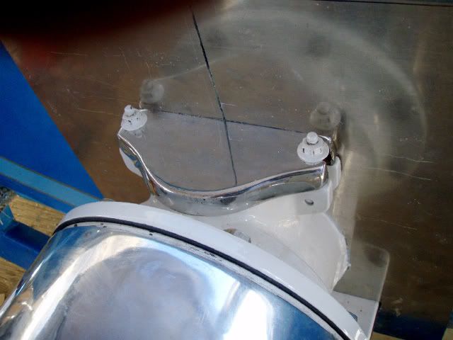

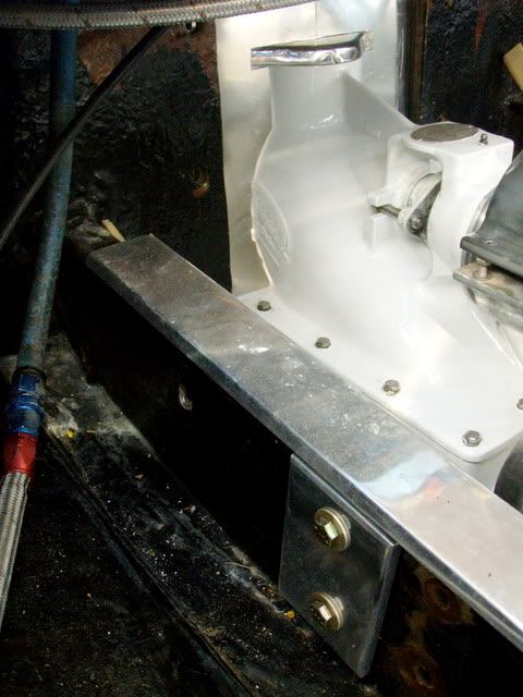

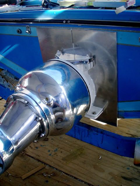

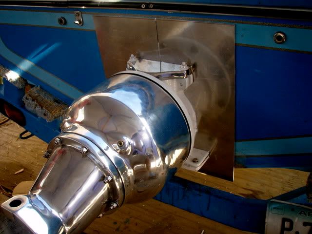

thanks for yeralls input, and I think the solution is to machine the cleanout cap down 3/16" and weld a peice of sheet aluminum to the cap. I spoke with JBP Tom and he seemed to think there is nothing wrong with this method. The pic of an inset box fabbed to allow the cleanout to still be functional in my case is a little beyond the skilz of a homebuilder, but supersweet at the same time. I Emaild Ray Black regarding you guys sending pithy sarcastic responces SO BRING IT ! Im pretty sure Ray's screen name is IRREBEL. Oh yeah, the pics are on the post "...basketcase ... third times a charm"

Youch! Like a feeding frenzy on the new guy! LOL, Allz good - and originally my question was whether one of you guys had a leak proof method of sealing a transom plate around the clean out cap. My idea is to weld an aluminum plate to the top of the cleanout cap and seal as needed. and all those pics were the womans - seriously!

Factory intake was crooked AND off center - leading to the dreadful phrase 'how far do you want to set your pump back?'
Anyone have any tips on sealing the transom plate to the cleanout cover? I was thinking of welding a flat 'cap' to the cleanout cover. Any tips would be greatly appreciated.
