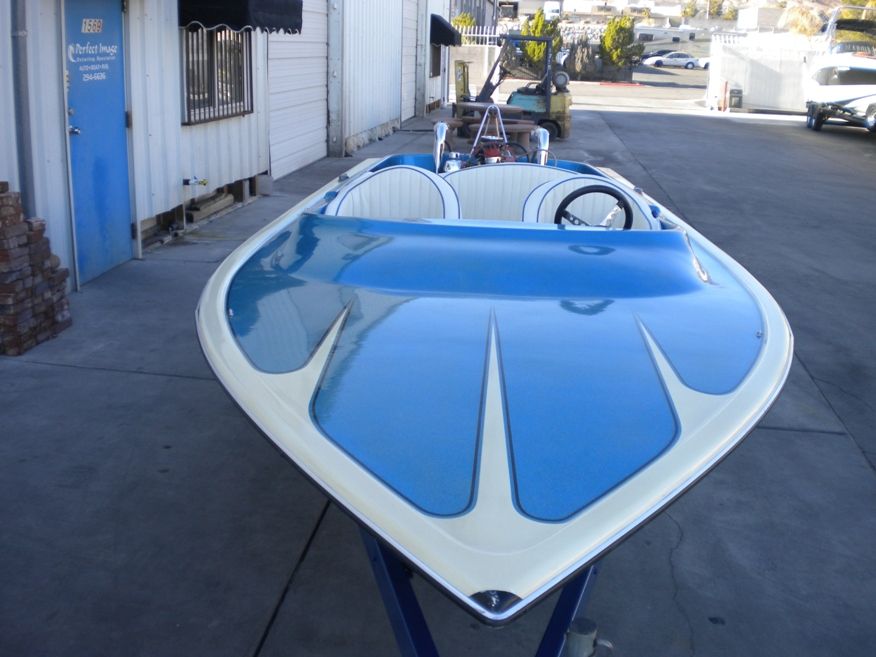

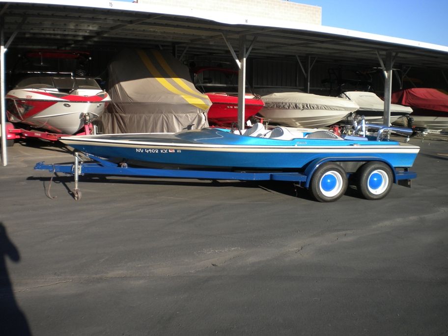

Boats For Sale / 1976 Hallett 19' Bubbledeck Gerard Hinderlich
« on: May 01, 2013, 08:06:21 PM »
Up for sale is my 76 Hallett.  I have gone through everything on this boat and it runs like a bitch!  I get comments on it wherever I go, and have taken it to the water 6 times this season already. Comes with 2013 Nevada Tags and Lake Mead pass.  There is not a thing wrong with this boat, and I am selling to upgrade to a bigger Hallett.  This is a Gerard Hinderlich edition, which was when these boats were being built, Hallett sent some of them to him, and he put in the Harman 460 with the special interior arrangement.  I have never seen another one with this sort of setup.  I have a 1" binder full of every receipt I have for the boat, including a copy of the original title, sales receipt, and build sheet.  I am the third owner.  Boat has a stainless bimini top w/ blue fabric (not shown), custom fit cover, and tandem axle trailer.

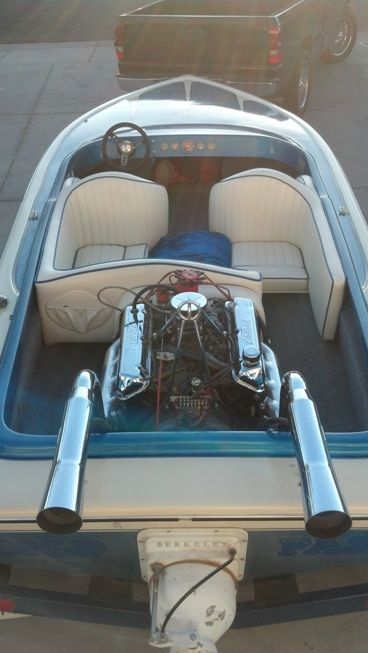

Specs:
Boat:
Brand new interior, 2 months old
3 coats of wax 1 month ago
Brand new grey Hallett carpet (Just like in the late model boats)
New steering cable and helm
New shift cable
New wiring from gauges to the entire motor
Autometer carbon fiber marine gauges
New fuel lines & filters
Twin IMCO 10 gal. aluminum fuel tanks
Harman 460:
New heads with Ford racing valves, CC'd, built by John Force's mechanic
MSD R2R distributor
Blaster SS coil
Holley 750cfm double pumped, vac secondaries
New gauge senders
New starter
Rewarder water-cooled exhaust
All new water lines
New plugs
Berkeley 12JC pump:
Stainless A impeller
Fresh paint
Rebuilt a few years back before I got it (Have receipt)
No place diverter :/
Trailer:
New paint (Honestly, the single thing I cheaped out on, but hey, its a trailer!)
New lights all around
New bunks (Wood & Carpet)
Sand blasted and powdercoated rims/hubcaps
New tires <300 miles
I know I am probably forgetting a ton of information for this, so do not hesitate to ask.  Like I said, I would like to see this go to a good home, fast, because I am trying to upgrade boats!
