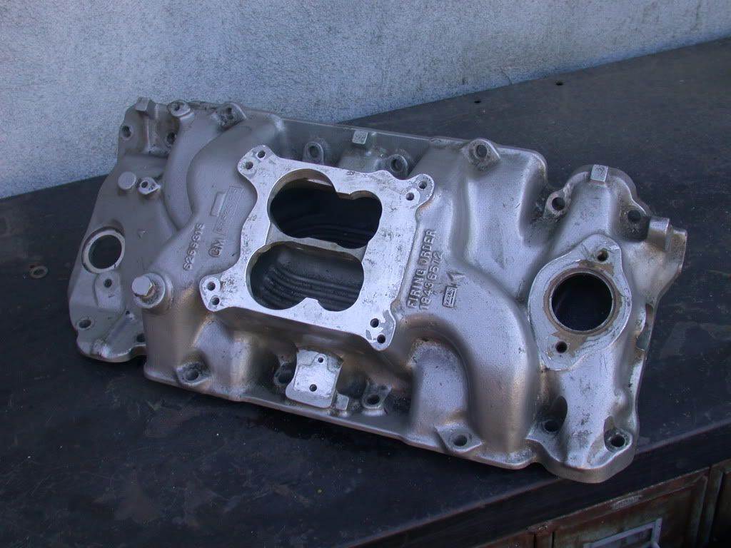

Engine Mechanical / Electrical / Re: BBC Intake Manifold Question
« on: April 07, 2013, 08:05:17 PM »
Thinking about swapping out my cast iron intake to aftermarket. Any recommendations on which one I should try? Air Gap was the first recommendation.  454 basicaly stock. Manifold needs to be low or medium rise due to engine cover clearence.
And does anyone have one laying around?
Do you have oval port or rectangular port heads?  You probably should buy one that matches your heads.
Airgap is probably a good choice, but even a GM factory aluminum intake, or a Performer RPM or regular Performer,, or the imported copies would work.  Without other modifications to the engine, it's likely that you won't see much difference, if any.  I have this GM rectangular port marine intake, with bronze lined water jackets for $150
