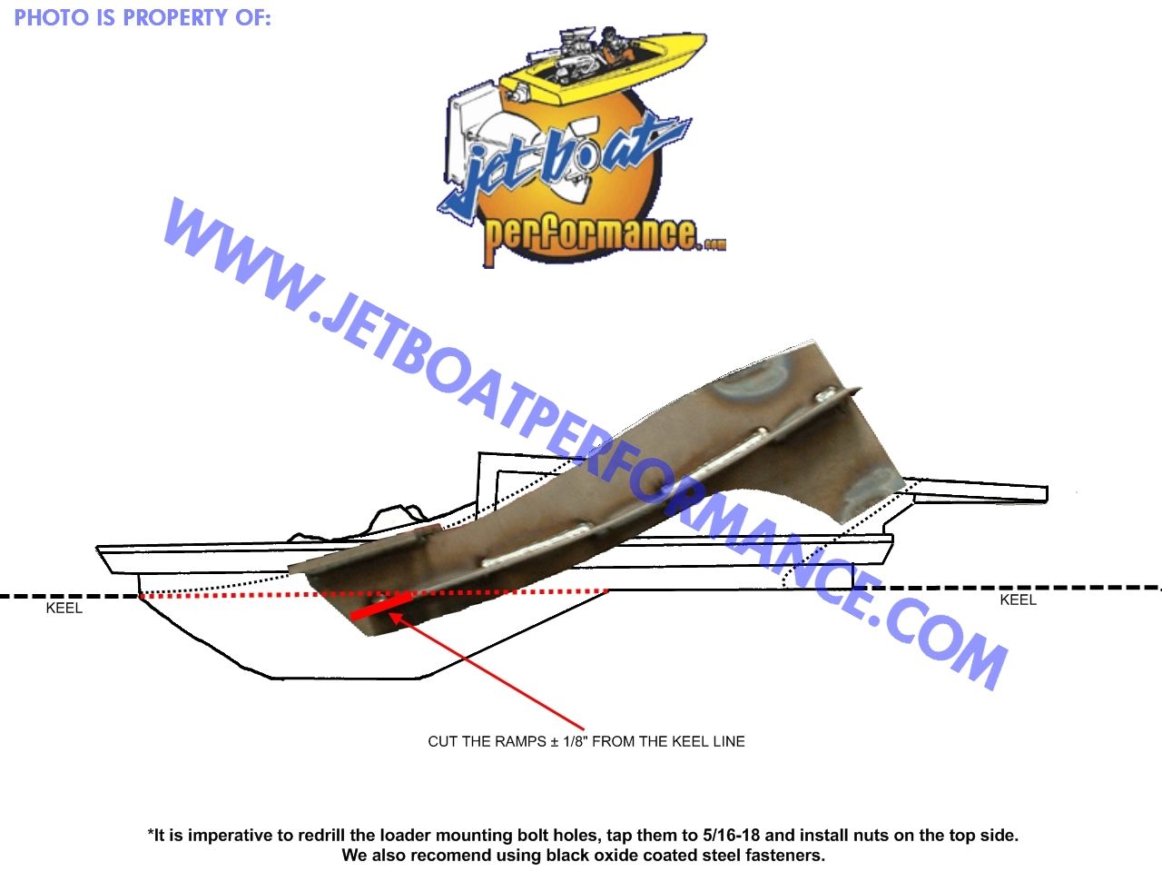

Jet Pumps / Re: Loader effect on engine rpms
« on: June 09, 2010, 06:40:15 AM »
Electro the Question is where were the leading edges of the ramp blades vs true keel ? does this boat have pressure taps/tap ? to read and tune ? (recommend this  ;)) Tom
Tom, no pressure taps.
« on: June 08, 2010, 09:55:13 PM »
If the keel line were right where the rock grate lines were then it was cut right on the button.
It's hard to tell the real keel line as the bottom of the hull starts to slope toward the jet opening.
He just cut it dead on where the bottom of the rock grate was.
« on: June 08, 2010, 04:26:21 PM »
Got a call a little bit ago.   It WAS the loader.  Interesting, now does that mean
trim more off the ramp??
« on: June 06, 2010, 09:57:39 AM »
So if that is the case what is the solution?   Speed and rpms are down.
Put the rock grate back on and see what happens?
Then change cam back and put the loader back on if the loader isn't the issue?
The up ramp of the loader was trimmed to be at the same point as the bottom of
the original rock grate.
What do you guys think?

Jet Pumps / Loader effect on engine rpms
« on: June 06, 2010, 08:25:59 AM »
I was asked today if a loader could cause engine rpms to be lower?   I don't see how
but you guys are the experts so I told him I would post the question.
He changed cams to a supposedly better cam and lost 200 rpms.   It's a 460 berkeley 12je A impeller.
The only other thing he did was put on the loader.  I vote cam.
Opinions?  Tom??
